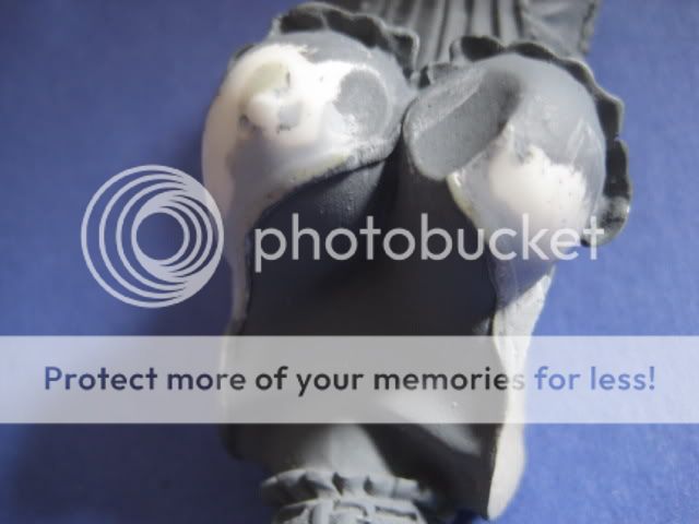

[quote]Question - Does the mr Surfacer leave a smooth finish? I ask, becasue to me, it seems that it leaves a slight texture on the parts?[quote]
If youre referring to the textured areas on my parts in the pic, thats the tamiya paint, not the Mr. Surfacer. Its possible I had my mix off a bit, or was too agressive with my spraying Im not sure.The Mr Surfacer was sanded with very fine wet/dry sandpaper.

Looks good so far Jim,
and yes, having to do repairs is all part of the craft! Looks like you did well!
Having never used the product, just asking.

here is the putty and Mr Surfacer 500 sanded and blended. The light area is the resin. I think it looks like a smooth transition, so I will prime again tomorrow, then take care of any pinholes I find.

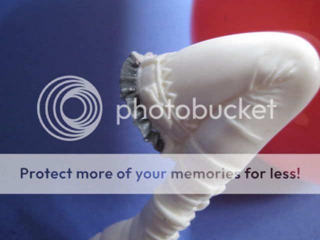

This picture shows the frills that were broken due to my clumsiness. I repaired them with lead foil, and CA holds it in place. I will add Mr. Surfacer once again here to blend everything together before priming it out..

Thanks Jaime for the compliment. I have been sanding the inner seam and am bridgeing the milliput and the resin with Mr. Surfacer 500. seems to be working well.
The edges of her stockings are frilly lace, and during the seam cleanup my fumble fingers broke off some of this frill. I rebuilt it using Lead Foil and I must say it looks good as new. Pics to follow..

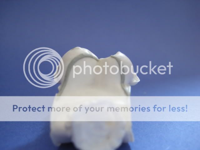

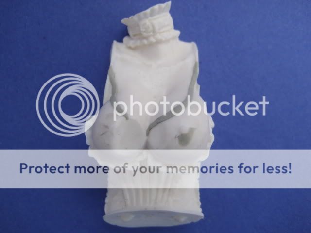

Thats quite good Jim,
That allows you to be discreet, without all the bother of a full blown re-sculpt!
Liked how you allowed for the fabric to shift, as her leg displaces the underlying tissue, most people would have missed that!

Posted: Thursday, July 29, 2010 - 04:17 AM UTC
Here is my attempt at covering her breasts. I rolled some milliput and added it as an edge to her covering. You can see in the second picture I did not make it symmetrical. Her knee is up and is pressing slightly, causing a bit of give. I will be sanding the inner edge of the strap to blend it in..

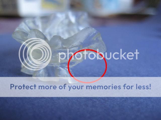

Jim, maybe you could fill in that void on the lace and recast it in clear resin using the repaired piece as the master. Put a thin disc in the hole and cast it in a slit mold...just a thought.
Maybe ask the manufacturer for a replacement after showing them a pic?.......

Posted: Monday, May 17, 2010 - 02:11 AM UTC
as for the transparent part, is the missing bit still around, or has it been lost in transit/ at point of packing?
Yes its definitely gone..I had found it in the packing material, but it disintegrated in my fingers...
currently Im thinking of just turning the missing area into a fold or something..

This clear piece was damaged during shipping. Im not sure how or if I can repair it. It is meant to be black lace, and should be painted and shaded using tamiya "smoke", and thinned flat black in the deeper shadows..
