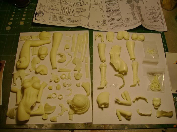

Alright so here is what is going on....These will be little side projects when im not building planes so at any time if anybody has any pointers please feel free to share...
These are the kits and how they arrived in the mail.....
This one is (since I don't speak Chinese)Vicki she is 1/6....
This is Rachael she is 1/8.....
After taking inventory from both kits to make sure everything is there and nothing is broken.Rachael unfortunately has one of her sword sheaths broken
will have to fix later

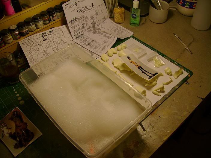

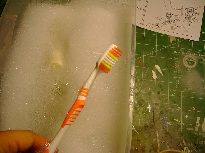

So from what I have read and watched so far the first thing to do is wash them in dish soap and scrub them lightly with a soft tooth brush.....
They are now air drying and will be put into bins until the next step
