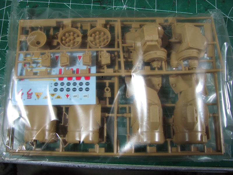

This is the 1992 Bandai release of the Destroid or "Missle Phalanx" as the box reads. It differs from the older Macross release that I am more familiar with from Imai and Arii in that there are no poly caps to create the moveable joints. Within the box are 3 sprue trees and one decal sheet and some VERY simple instructions (the old kits even included a tube of glue!). The parts are all molded in tan plastic so if one was not confident enough with their painting skills or lacked an airbrush, you could fake it. The plastic is well formed and mostly devoid of any flash. The Molding seems crips and detailed for the kit, i.e. what detail IS there is nice, but this kit is not particularly a masterpiece waiting to be built, if you know what I mean. That is not to say it is a bad looking kit, just simple. Most of the parts are connected to the tree with smaller bits and removing the sprue is easy and cleans up well with little to no problem.

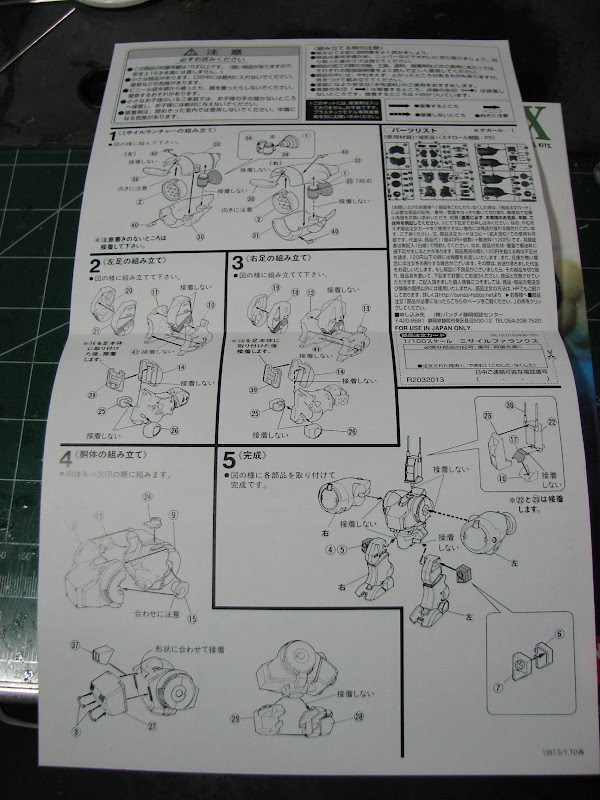

The instructions are a bit over simplified and could be bigger for us old guys but, what are you gonna do, right? Step one is the assembly of the arms, 2 goes to the legs and so on with only 4 major sub assemblies. Step 5 brings it all home, so as I said easy.

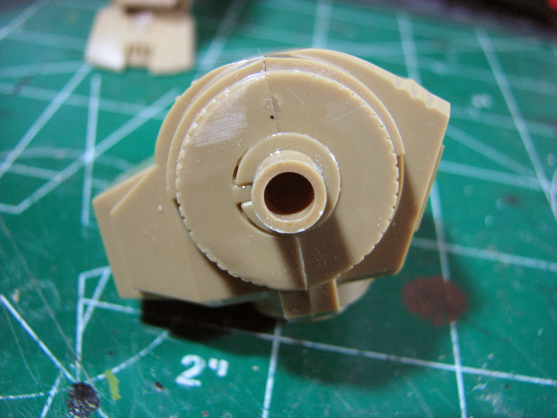

I started today with the legs as they seemed the most basic. Fit was nice and went together with little effort and little hassle, none actually. Fit was nice and only required a bit of seam clean up once the glue was set. A little surfacer will eliminate any residual seams. The torso and main body went together similarly well and only required a bit of pressure to make sure the fit was tight. Again a bit of sanding along the seam but nothing unusual. Head is a small affair and needs some surfacer along the side seams to eliminate the joint, but again this is par for this course. The arms/missile tubes were the only part that required some extra attention. The seams are good and the fit is nice, but the seams needed to be filled and sanded with some surfacer more so than other areas, just so that the joint will not show. The inside of the missile area needed a small bead of fin styrene rod to close the gap between the wall and the missile housing. This was again easy and looks good when done, I think I used .020 rod. I am waiting for the surfacer to dry for the next sanding and then wash and primer. Cheers.
